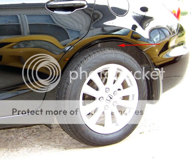

Below are the before and after shots.............Hope you enjoyed this thread and happy Wrenching!!
