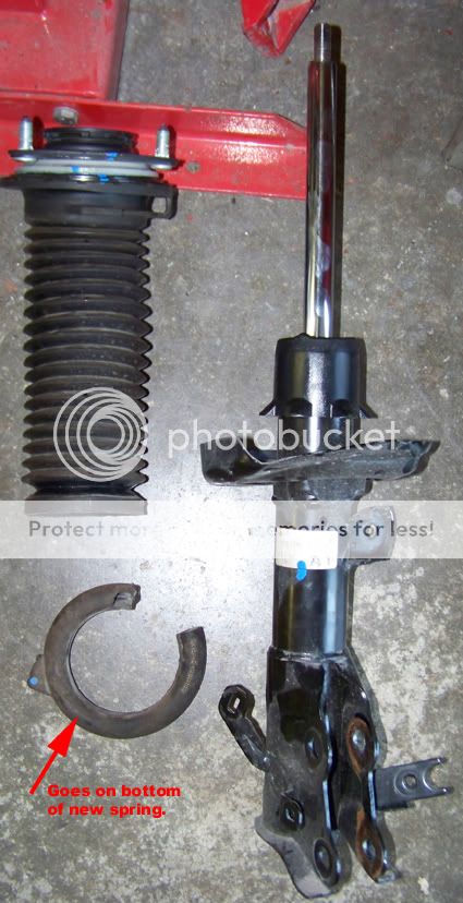

Next steps are to be performed by someone with equipment that can help compress the springs. Feel free to stop everything at this point, gimme a call and I can get this step done for you here at the shop!!
Mark your top hat and shock with a line or guide to ensure when removing it all, that everything lines up to where it all was before.
With the spring compressed and components off (such as the 17mm nut up top etc.) All you need to use from the old setup will be pictured below.
